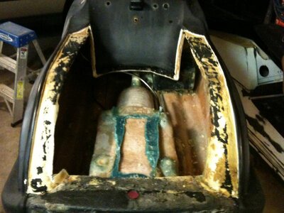

I picked this rev hull up from a guy around town that never finished it for a really good price with everything he had to make a complete ski. Well its about 75% DONE so i just wanted to share my pictures with you guys and get ur info and likes and dislikes about what i have got going on so with that said here are some pictures of what it looked like when i got started.

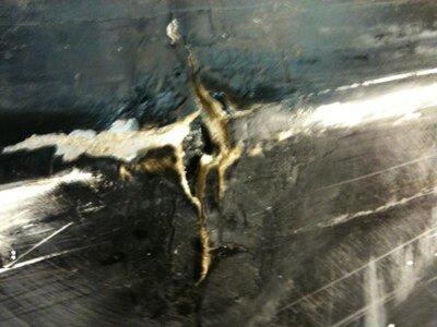

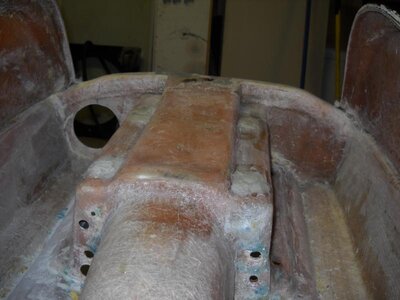

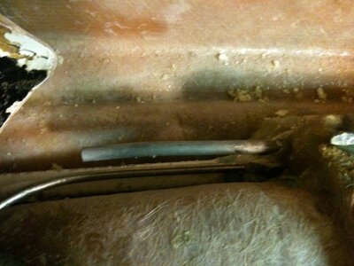

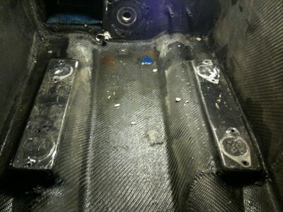

After i got done cutting grinding cleaning and getting it ready for its new life, i began to rip out every single cooling line exhaust and drive lines all to be replaced with brand new stuff. i ended up adding 2 1/2" aluminum exhaust tube along with a one way valve and new 1/2" aluminum water lines along with a trim tube. The hull its self had 3 massive cracks on the bottom of it so i patched them all up with 1708 cloth. I pulled out the motor plate and re mounted them in the hull to get the motor and mid shaft better aligned. made a new hood liner from carbon fiber as well added lots of carbon in other areas to try and save some weight (DID NOT END UP SAVING ANY WEIGHT LOL) after getting the tray back together i decided that adjustable bob foot holds would be a nice thing to add so i bought a set and got them put in place. there is probably alot im forgetting so please ask any questions u would like and i will be more then happy to answer them. More pictures :)

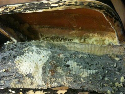

i have never rode a freestyle ski, But had a kawasaki 650 3 years ago rode thst stupid thing litterly everydsy after work and weekends ALL summer untill i crack the hull from the bottom up. sold it and then last winter bought a super jet that i thought was good well that thing was another story for another day tryed to fix it and ended up with this Rev. This Pos was water looged to hell has 1/4 inch of standing water in it after i defoamed it holes every where and all the threaded inserts were junk along with the exhaust and all the other lines replaced resealed layed 20oz carbon over pump tunnel and put that pink foam in the bottom of tray used a litttle bit of foam to get the shap of tray i wanted (IMO foam is a waste of time/pain in the ass to shape and cut perfect next time im doing some kinda airbag or come up with a way to make the tray air tight) then after i got my shape with 2 part foam i layed 3 layers of 19.6oz toray carbon fiber to buil the tray back. thought BOB holds would be cool cuz i have yet to see them in anything other then a SJ. then patched all the holes. and know just finishing thing up and prepping for paint. Sorry about my poor ass typing/spelling but if i spend all my time learning proper english i wouldnt be building jetskis.
