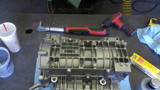

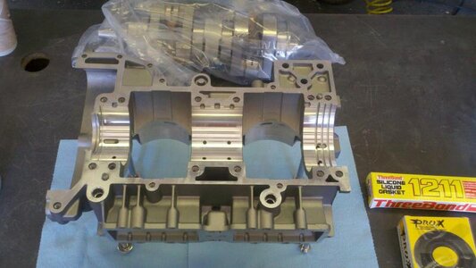

It is time to assemble the mighty Gen3 1200.......the cases have been epoxied and machined. All surfaces are clean and ready to go.

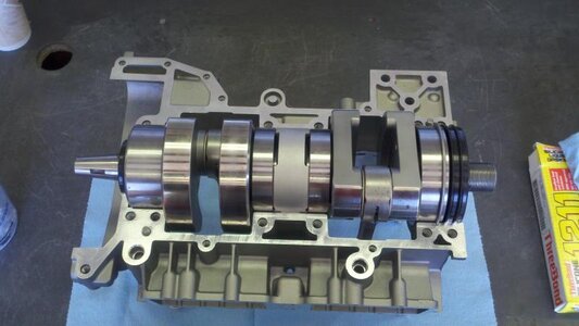

This 1200 is using our new lightweight billet crankshaft. It weighs in 6.1 pounds lighter than the oem 66e crankshaft. It is still a 78mm stroke, but can be made up to 88mm stroke. It is machined out of 4043 billet steel, heat treated and finished using all oem yamaha bearings, labrynth seal, and hot rods. The rod pins are hollowed to make lighter. We will be offering these for sale in two weeks, just waiting on Yamaha at this point.

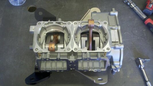

The bottom end is now assembled and torqued to spec. So far so good:Banane36:

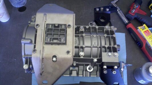

Next, I put on the WDK mount kit, which is made from billet aluminum rear ears, and a steel plate that is nickle plated. It is very strong and we have had zero failures with this in 7 years of use. The Rok-R hull was designed to assure this would fit with NO grinding.

The bottom end is now complete with the mount kit. It is time for the huge top end this engine has.

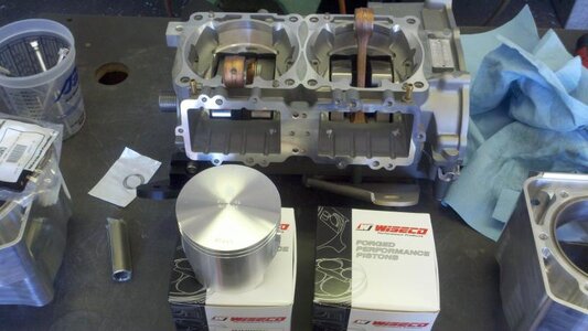

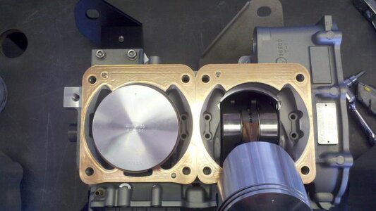

The pistons are Wiseco 98mm forged "monsters". They are 80 grams lighter than our previous version. The whole focus on the Gen3 WDK1200 is to make it rev hard and super fast. The torque and power has always been simply amazing. The addition of our stamped chamber, billet exhaust manifold, and now billet crank, with lighter pistons..........well.............hang the F*&K ON!!!!!!!!!!

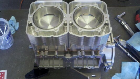

The massive billet cylinders are ready to go on. We use a high quality copper base gasket.....no cheap paper here:scratchchin: Did I mention the price of copper? HOLY COW!!!!!
The cylinders are now on......piston clearance, and ring end gap is perfect!!!!!

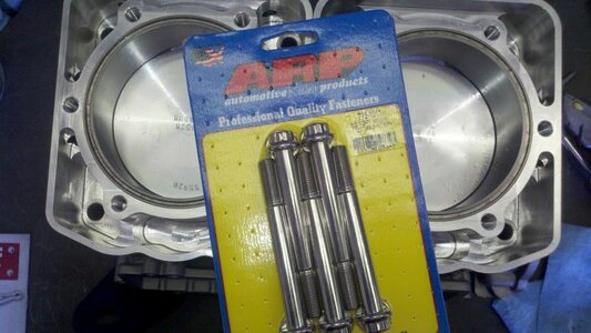

Only the best for the WDK1200.....ARP......no corners are cut!!!!!
