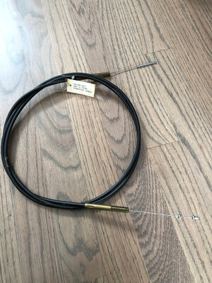

For those following along, I ran into a compatibility issue with the OEM throttle cable and new carb. While browsing eBay, I came across a newer 90s WetJet throttle cable that appeared to have the same components as my OEM cable except for being longer. Decided to bite the bullet and purchased it. I am glad I did! The cable is identical except for being maybe 2 feet longer than my OEM cable. Even better, the new cable was a NOS with original tags. Here are a couple photos of the cable with the new SBN38 installed. I used the OEM throttle cable sleeve, lubricated the line and polished the brass fittings.
