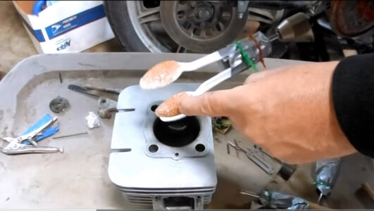

What are people's opinions on the Lisle 15000 ENGINE CYLINDER HONE? Obviously, they aren't as nice as a Sunnen but they are also a good bit cheaper.
That will work just fine ,Ammco also makes a good cylinder hone
Here's a related question: What is the series of grits you would want to use when honing a cylinder? Lets say for both the case when all you want is a light deglaze and for the case of starting with a fresh bore?
