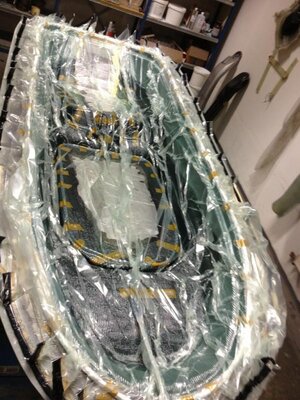

The reasoning behind the second vacuum setup to sandwich the Nomex core is to not saturate the honeycomb and add excess resin and weight. I feel like this is a good start but others may disagree. I will be making lots of ride plates before we get ready to lay up a hull. That will give plenty of time to experiment with different layups and see what does and doesn't work. Feel free to add opinions and experience.

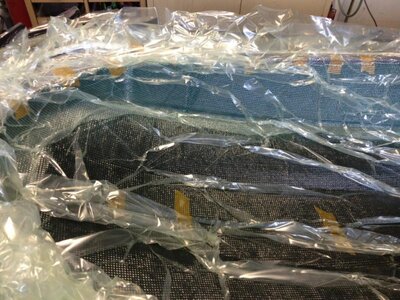

3 layers off 8.9oz is much to thinn.....with sandwich build its enought for riding but not enought for putting on trailer, touch a ston andso on. Worked many years with honeycomp and i can say: its a nightmare!!!
Lay some layers more and use pvc-foam on sides and middle flat area of bottom. You have to make 1 vacuum and 4times in case of using honeycomp!!!

I have asked the same thing to an aerospace composite guy that uses lots of honycomb and he said not to and to
use something like pvc foam, he called it something but i cant remember...
He also has me using visual carbon only on the first layer if its going to be seen and then i use a biax carbon 45*/-45* to build my strength... If i want thickness then he said add the pvc foam

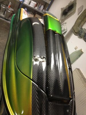

props on that sxr in your post, I love the green and visual carbon!!!
