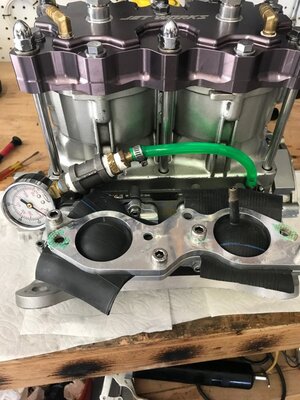

Did a little pump surgery. Cleaned up the mag stator and bored out another stock housing. Lathered up the mag insert in sealant before sliding together so it water shouldn't be able to work it's way in again.
Installed new drive/mid shafts and installed pump. Went together with no shims this go around.
Ran into a couple frozen bolts in the RRP pole (despite anti-seize). Ended up drilling 5 of the 6 large bolts that pinch the tubes and using longer bolts and nuts, no more ss in aluminum threads. Reassembled the pole and installed, just waiting on the crank and cylinder to show up.
