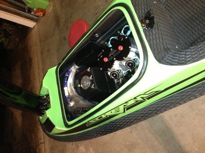

A ton of work has been done the past two weeks, and I'm really starting to see the light. I ran all the cables, set up the steering, trimmed the chinpad, attached cooling lines to the pump, installed the battery, and set up and installed all TL components. I've never done the ignition before. Holy $hit. It's an entire day's work to get everything set up right, and make the wires not look like a 5 year old did it. Tricky really helped me out with it.
I spent today mocking everything up and making brackets to secure the tank. It feels so good to see the motor, pipe, ignition, and tank in the ski. It makes all the hard work not seem so bad when it starts to look almost finished. As of right now, really all that is left is to put carbs on, secure the pipe, and run all the cooling and fuel lines. Then the tuning begins.
