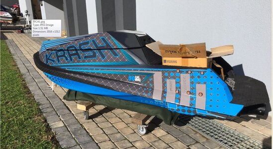

I just bought a new 50CAL surf hull and pump only from Chris Grace ...it just arrived and I will be posting up my build once my other parts arrive from JM. I have already built up a carbon Superfreak with TPE1105 from Tem, and also a Rickter FS2....JM781.both which I love...
My initial views on the Krash 50CAL is wow...its really pretty and the quality of the finishes appear to be very high inside and outside....hull thickness nowhere near the Rickter which is built like a tank, closer to the SFreak thickness, but SF is carbon, ..after 5 years of hard riding...not even the slightest sign of stress cracks.....time will tell on the 50CAL
50CAL hood latch setup looks awesome but impratical and wont last a salty season...though a well documented zero dollar fix is already posted (and I did get a brap strap included, so they know this)
I heard about KRASH pump issues from some members, but it comes very well installed, shimmed, feels very smooth, etc, so will run it with my DASA 900 and see how well it performs
