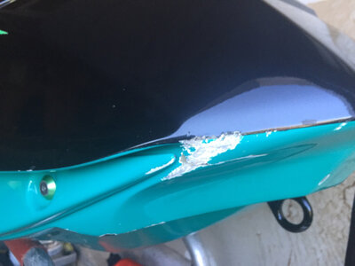

Is that just cosmetic?! I've stuffed the nose in the bottom plenty of times on mine with no structural damage. I don't even get the scuffs because I have that clear plastic film on the front of my skis that they put on cars to protect the front end from rock chips...

Yea, just cosmetic, rocky bottom in the delaware river, not sand. I'll have to smooth it out with some epoxy and paint over it. I didn't even realize until I got home never felt it hit when I was riding.
Good idea on the clear film, where do you get it? Is it like vinyl wrap just clear?
Glad to hear its just cosmetic, looks bad :(.
I used the same stuff on my Footrocket, it's called 3M paint protection film, I bought mine on Amazon. It works great, I bounced my Footrocket off bottom a few times learning flips and there was not a scuff on the nose.
