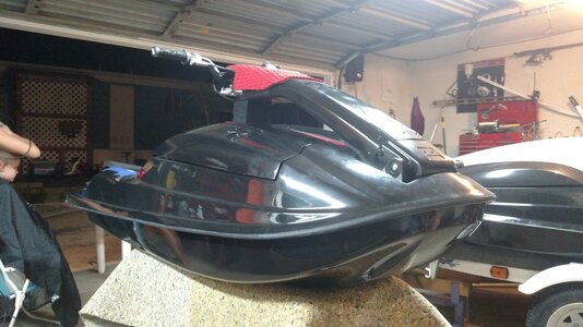

Factory B pipe. Yea, Josh just told me that it might be a problem. Although, I am not using the stock Superjet eBox mounts. I chose to use rubber anti vibration mounting spacers. It causes the eBox to be mounted tightly up against the firewall. I'm hoping when I drop the motor into shim all is good and I don't have to move anything.

Guys don't be scaring me with all this fitment who ha! Ill be using couch mounts as well! And just a b pipe! jo5hi3 what exhaust you running?

It's alot shorter then what it seems in the pic. I might have to go shorter. I'll find out once I get her on the water
