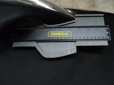

Holy poop that thing is genius. Where do you get that?!
It's a woodworking tool, I'm pretty sure I got it at Lowes when they carried General Tools. You can different brands that have plastic sliders 12" long. I use the General with the metal pins the most though, most accurate. Great for turfing also, here's the plastic one in action:
That's awesome. I just asked at work and someone has a few they're gonna let me use. I owe you!

That tool takes all the guess work out of it man. I can use it on the bottom of my pipe to get the contour right too. I'm seriously mind blown at how simple that is and how well it will work never have I been so excited for a tool!

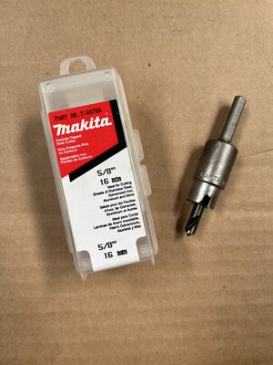

I am terrified to drill into this thing! I got the recommended step drill bits Jeff told me to use. For my rip I just used standard drill bits and had decent luck. For gelcoated carbon do you go max speed and just ease into it? My only concern is flaking/chipping the gelcoat. Wish I had a test piece to drill but I really don't.

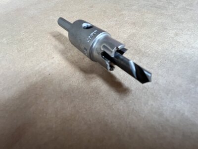

The miniature hole saw is a Carbide Makita bit, that after I’ve measured twice, pilot holed with that teeny drill bit (3/32), I run the hole saw BACKWARDS BY HAND to score the surface, then move to the OPPOSITE SIDE, where I run it by hand, alternating till completely thru. My hole saw is undersized intentionally, I use the cone grinder bit on both sides , and sand paper on a dowel for final fit.

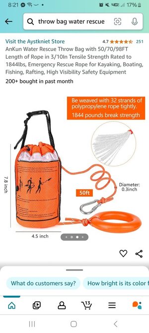

Ya'll think 1800 lbs tensile strength is enough to pull a ski up from the depths?? Screenshot_20240701_202108_Amazon Shopping.jpg

Knowing the location of the sink ski is key. That would provide that.
But what would be a simple formula to answer your question, would the skis wet weight plus the volume of water the ski can hold X the weight of the water be close ?
I was guessing 40 gallons of water volume ? @ 8.34 pounds a gallon plus 280 pound ski ?
280+333 = 613
Maybe add a factor of 30% so plus 183 = 797
I have no idea what’s the correct calculation, but off the top of my head, seems like it would work ?
