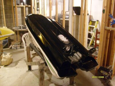

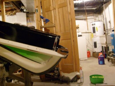

This is going to be a fun summer.Cant wait,all this hard work will pay off.Plus iv
learned alot by doin this build.Next step is getting more carbon,blew through
most of it already.Deff goin -6 pole now.
Wasnt able to finish the coupler cover due to the rush on getting my buddys SXR out the door.Just got done painting the lower deck and -4 cut hull done.U can see the rest of the build.Thread SXR build up by SXRGUY.Hangtime (Art) is comeing down deff on saterday for the waterbox test we will see how it go's.It will be tested on his built RN.
Now that the sxr is done i can cram on mine and get it movin...
Soon that is what mine will look like =)

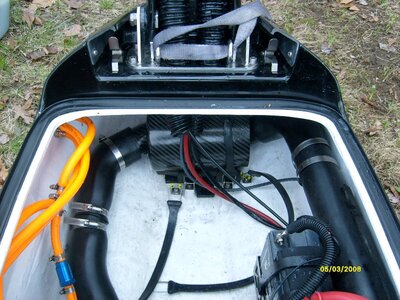

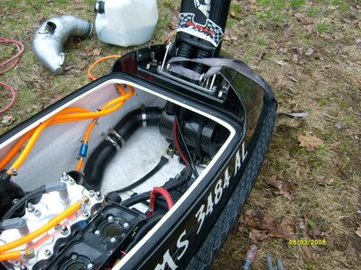

Tested out the waterbox today with Hangtime (Art).What can i say,im very happy with the results.Arts boat had some fuel line issues we fixed,and he had new carbs today.So we tuned them in as well as we could for the time we had with the factory waterbox.After getting the feel for that setup,we installed my carbon and the fit was perfect.Sound was perfect as well not loud at all...a nice rumble Not much louder than the factory.And it wasnt turfed.No dyno but the power was increased through out the rpm.Art felt this first,then i rode his ski next and felt a increase aswell.He was able to
take a short vid so he will throw it up when he gets a chance.Thanks Art for comin up and helpin me out..super nice guy and look forward to riding with u soon.

It was nice to see Bens work in person , he wasn't kidding when he said the carbon fiber tube weighed like 2 empty soda cans .
We were not able to test out the tube due to not having the right couplers to mount it but we tested out the waterbox .
It fit perfectly without any modifications .
