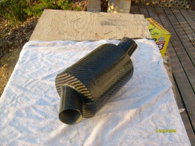

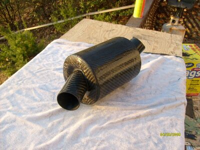

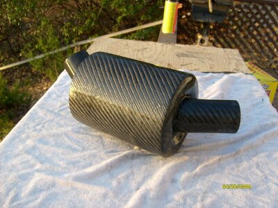

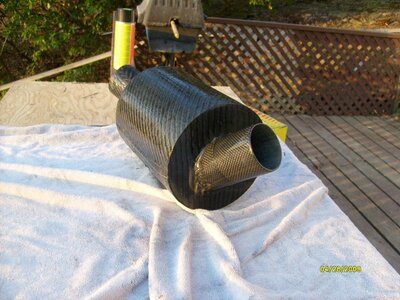

Pics of waterbox.Spayed it down with water so u can see.just need to wetsand and high temp clear and it will be 100%Stinger side tube is
long so when its time to test it can be cut to fit perfect.

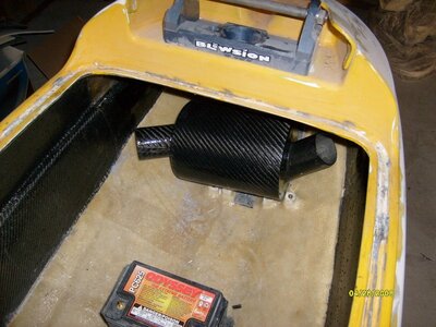

The turf will cut the noise down and keep it safe when strapped down.Thanks for the credit guys..hope it serves more than looks and weight.Id like a throty sound but not to load,exceed or meet the same power as the factory b waterbox.Only diff is mines round and the inner tubes are 6mm bigger.Ud think 160cc more than it was intended for ud go bigger on the baffles a bit...so thats what i did.

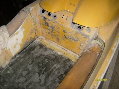

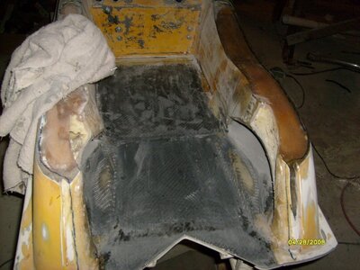

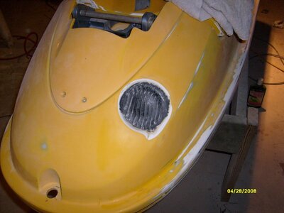

The gas cap hole is almost done 2 more peices of carbon,and sanding...Next is something i just haveto do,as u can see in the pic theres a blue line going around the perimeter.Ya u guest it im cutting the whole tray out.I dont like the way 24-7 put in the foot holds,i dont like were the foot holds are..now that it is a -2 hull.And i want to make it lighter in here and i know i can,and stronger.The whole thing is going to be carbon,and its going to be one peice...foot holds,tray side tops,ect.I need to sand and make it perfect in there and make a mold.After that i can cut the tray out,and get rid of
of that heavy peice of junk thats been tampered with in so many spots.Ill be showing the process soon.
