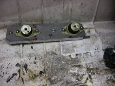

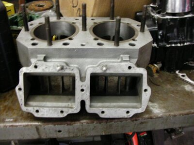

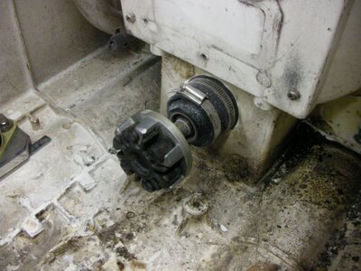

Quick update:
To save weight, the 800 motor has been axed. Instead- Using a PJS 550 reed motor!
Floating driveline has been installed and custom mount plate for the motor mounts is in.

Quick update:
