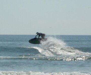

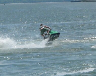

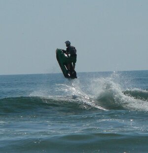

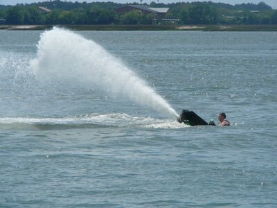

a few new pics from this weekend.... first two at Huguenot second two at local flatwater spot.
First pic is the best one I got of my stabs, I didnt get one of the dive in but My girl did pretty well taking pics..
