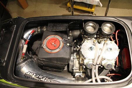

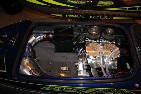

I dont believe in such a thing as too much power,its very easy to bring power levels down with a few water changes for surf and chasing boats,then when you want max power for flat water fun,quick change back.
truerider,whats your impression on the throttle response and low end power of those 2 setups, They are made very sim in terms of flow though right? Throw a few more things in hypothetical comparison,85 mill pistons,nikisil bore,larger transfers,and aux exh ports. IF the price were really significantly lower than a 1100 or even bigger motor needing billet cases and was capable of throwing big flat water tricks and perform well in surf, would larger cc be necessary ?
hink.. the ET is a nice option right now,the dyno time put in to get those ports right is impressive,as well as the other parts tested and changes to the power curve documented,is a real plus,less hype more facts means alot if you ask me.
