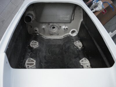

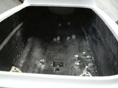

I got two sides re-enforced this past week with 12oz biax and 11oz carbon only to discover I have a F-ING BUBBLE :17:in the left side under the carbon. I'm so pissed so out comes the grinder this week and off course it is in the only part of the boat that you can see when everything is in.

Its a bubble, who cares. I know you want the ski to look sweet, but for a bubble in the glass, I'd Slap an LPW sticker over it.
