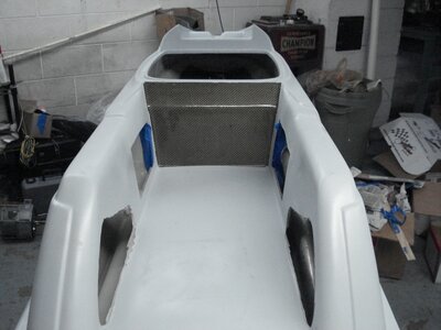

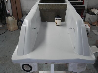

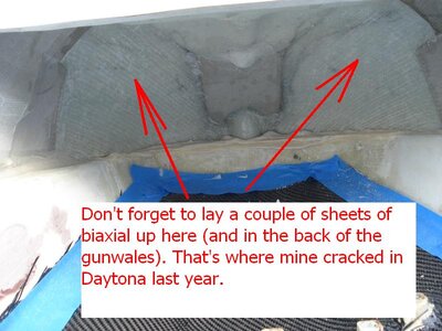

Looks awesome man! You're not going to believe how great it feels when you finally get it in the water. Don't forget about beefing up the non-divinycell areas.

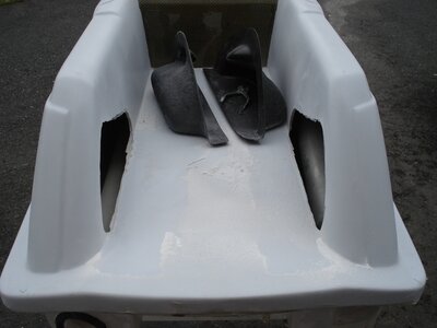

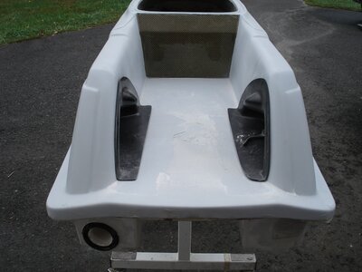

So I weighed it today and it came in around 85-90lbs (my scale gave me different weights due to pavement) that is with tubbies,exhaust,scupper and bottom re-enforced. Should I be pissed?
Not at all! Mine came in at 88 lbs when complete and I was ecstatic! The bottom deck is 56 lbs and the top is 12 - that alone is 68 lbs. Once you add on bonding, reinforcing, nose building, and FOAM, that number grows fairly fast. Heck, my 4 lb foam accounts for 12+ lbs alone.
You'll love it when you put it in the water. You'll never be happy on a stock weight hull again. :grouphug:
I still have to re-enforce the sides and foam. so I will probably end up at 100 lbs.
