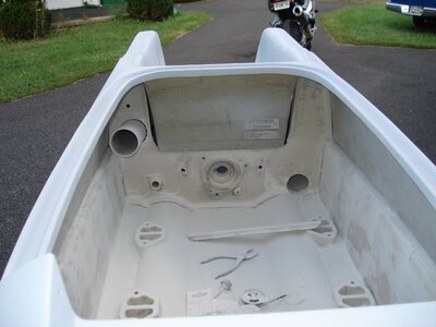

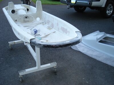

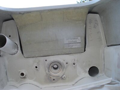

Rear exhaust is in ans sealed now. I filled all the holes with 404 and then glasses over it with 17oz biax to keep it held in. I will try and get a better pic of it up for some reason it keeps coming out blurry.
not trying to throw a wrench in here, but I can picture that exhaust leaking 1-2 years down the road after some flat landing and such... I may be wrong, but I think you need to 5200 the area where the pipe mates w/ the fiberglass, just to make sure it doesn't leak down the road...
do ya think that's overkill????????
it's just a suggestion...
I didn't want it to leak. Caker's is leaking and his is only epoxied in thats why I layed a layer down. I plan on running a small bit of 5200 around the seal just to make sure.
goop that ******** up!!!!!!!!!!

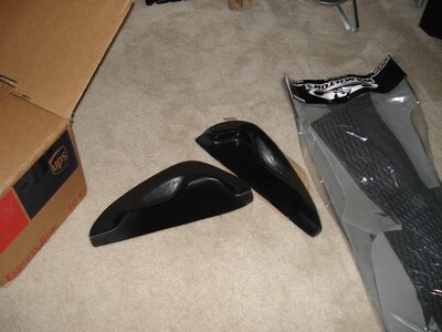

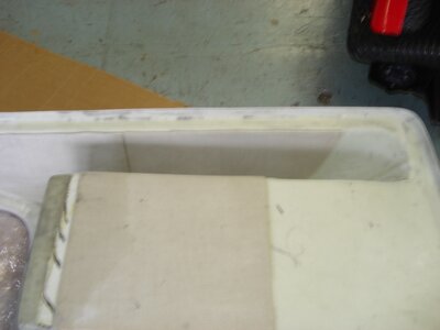

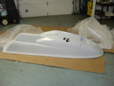

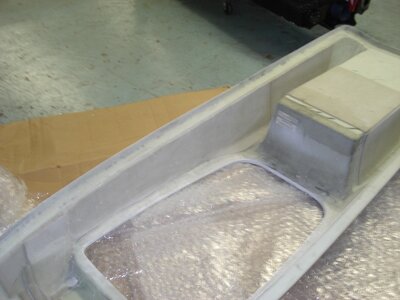

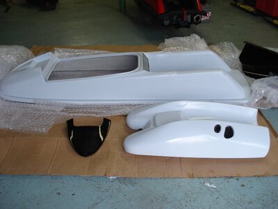

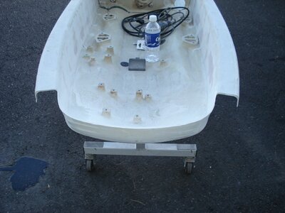

Look what I picked up today..... :cheer2::cheer2: Sergio told me I would get it in 30 days to my door and he got it to me in 28. It weighs nothing and is re-enforced in all the weak areas. All the hole are drilled for the hood and nose piece. I give sergio :biggthumpup::biggthumpup:

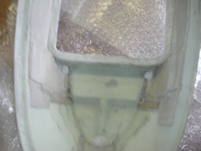

X-mass again just now, what a day my wammer cyclones and mat kit(didn't feel like making on at the time i ordered.)
Didn't it just blow your mind when you held that top deck in your hand?!? SOOOOOO Freaking LIGHT!!
It looks AWESOME!

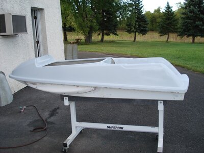

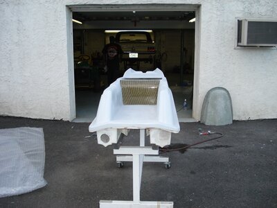

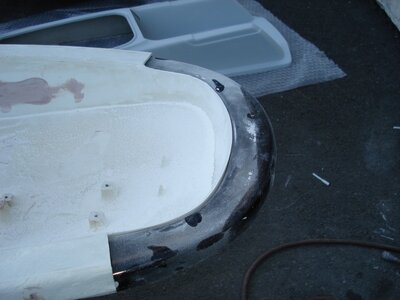

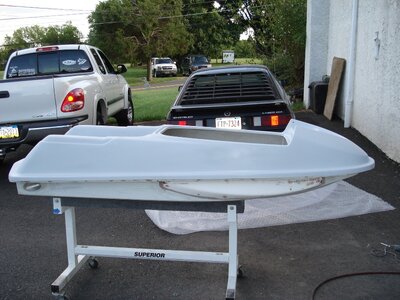

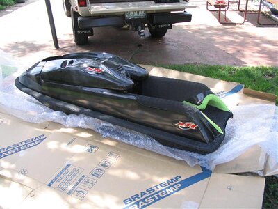

While everyone was reading another thread I decided to get some work done. I cut the nose off and fitted my topdeck. I still have some fitting todo on both by I am real close. If I wasn't getting married this weekend I probably could mount it
