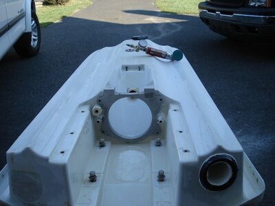

Got my scupper, cooling lines a installed and rideplate/intake mounting hols 404ed today. I also started the nose piece which I can tell already that I f-ed it up(tomorrow am will truly tell).

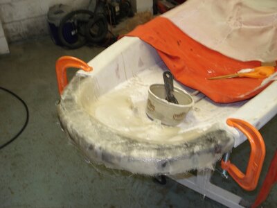

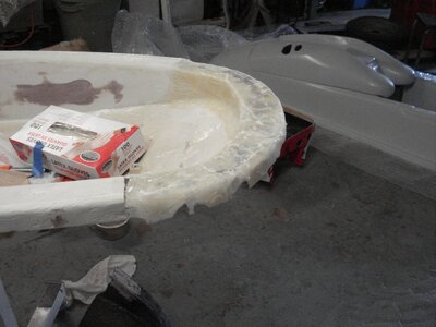

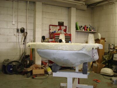

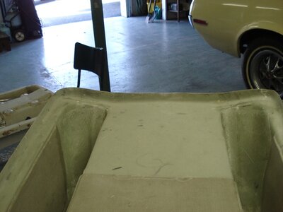

Since I was getting married at 2 I managed to pop the mold off before I went. It came out ok, i had to grind down some spots in the front to get the top deck on . I layed some 17oz on the top today to bring it up level with the sides its not pretty but it will hold. After it dries I will grind down the excess and fit the topdeck back on. Once it is fitted I will lay up some glass from underneath to re-enforce it.

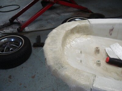

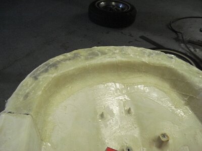

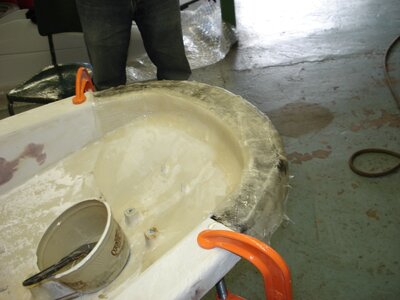

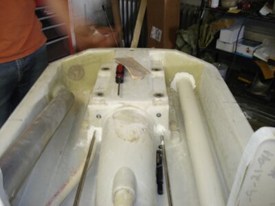

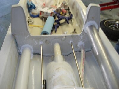

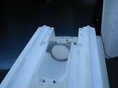

Slow day today. all I got done was the pump shoe fitted and filled in some more creases in the bottom of the hull. I also prepped the nose to lay some glass on the underside of the lip.

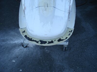

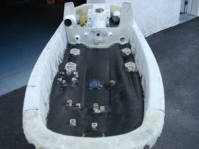

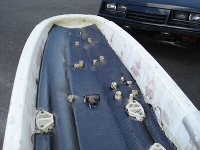

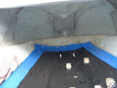

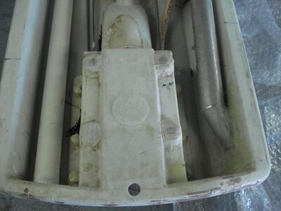

I got the bottom of the hull almost ready for paint but got tiered of sanding today so I laid a layer on carbon down in the tray . It was my first time using carbon and was unaware that loose strands would turn into hair balls when epoxy was brushed on them. I tried to get most of them up but the epoxy started to flash so I stopped.

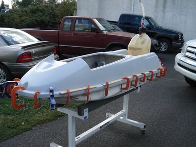

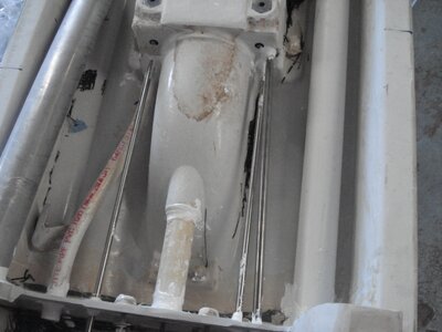

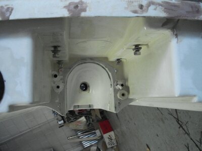

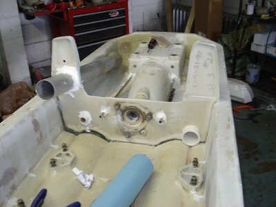

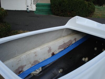

Got allot done this last week. Sealed the pump bolt holes, installed my trim tube and put some reenforcement on the top deck in couple of places that were a little thin. I also got it mounted :beerchug: with some 404.

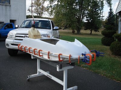

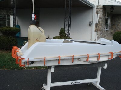

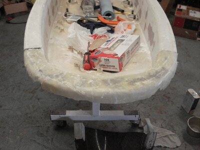

Some pics of the top deck.
