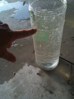

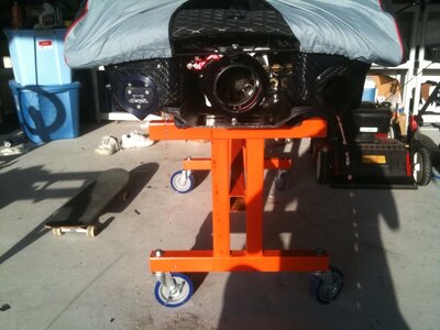

Well this afternoon I drilled some drain holes for the tray, I was moving it & heard some water in the tray. Drilled two holes & drained 3 gallons of water, sure is nice not having 2 part foam. Its time for a new RTR weight now it lost 25lbs of water.

You got that much water intrusion so quickly, in a fairly new aftermarket hull?
Nice that it's not 2-part foam. Is that a standard feature?

Dry ski... there is no a such thing!:censored:

LOL, wut?
Yeah I guess all ski's get water in the tray.... But Rickters have no 2 part foam which is great, I was told it has Poly foam blocks.
Thats what I thought, time to hit some flatwater now... Now if I could drop 25lbs that would be the Sh*t...
Your right brother, I remember draining my freak....

I drain my ski after evey ride and I get quite a bit of water (becuase of 1 way). Not a big problem really...

thats a crazy amount of water man!!!
im going to defoam mine just to be sure cause no chance im losing 25lbs (wife would kill me! she loves junk in the trunk!)

Yeah its going to be a drain after each ride, but it sure is nice with no water in the tray, no wet foam to deal with.

Josh, look into installing versiplug drains. They screw in place of regular drainplugs and will continually drain the hull when you're moving, but not let water in when you're sitting still.
I don't know if you're taking on enough water every ride to justify it. In my case, I had nearly two gallons of water after every ride, so it made sense for me.
Thank Matt, my problem is theres no room for a full size yamaha drain. I'm going to try Boyer's drain, other wise I'm stuck using a screw.
check out the lower profile Versiplug R-s.
http://www.pwcdoctor.net/VERSIPLUG-R.html
Thanks Boyer, it looks like that may fit. There's not much room with the exhaust tube & scupper.
do you know were it leaking from yet??
I pumped a little air into the tray & found some leaks around the right rear bond rail. Its not a big deal you just have to drain it after each ride. My thoughts are maybe the exhaut or scupper tubes leak some. On my Rickter the scupper is built into the hull so no PVC pipe is used.
I'm going to drain it after the next ride & see how much I get in one 2-3 hr ride.
All hulls get wet, We just refoamed my buddy's Superjet. Spent alot of time sealing things up. It drains 1-2 gals each ride. Just life I guess
