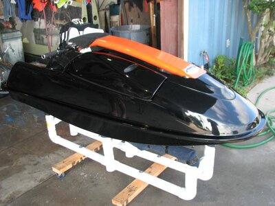

Ski is getting close. Just have to turf it & install the Brap Strap, some zip ties & its going to the water!
Aircraftsalz
Thrust built Dasa Power
Off site
Its almost done, Just got to turf it. I rode it without turf this afternoon, I can't believe how this ski rides. My 860 motor feels like a new motor now. The Ski weights 248.5 lbs Full or Fuel & ready to ride. (No Turf). It rides so light, its going to take a ride or two to get use to it. It has the power to BF without a problem, tried a few but couldn't keep my arms or feet attached to the ski. Riding without turf sucks!

Here's some PICS of the inside. I still have to add a strap to the tanks, & tie up some wires, etc,

dude you almost knock'd yourself da' :):):):) out..... badass rotation with no turf and still needing some work
First my hand came off, then my feet. I landed next to the ski, my brother thought it hit me. I think with turf, I can workout the BF. I might need to change props. This ski is 90-100lbs lighter than my Orange SJ!
wow! i cant help but be jealous!!!
good job!
Bro, I'm so happy with it. I can't wait to ride it with turf. doing the turf tomorrow!

what prop is in it now?[/quote]
Scat C75 13/18
I like it with the Rear only Exhaust!
Your going to like it, it rips! It rides nose high, but very fun to play with. Slids fine, but will hook up when you turn.
