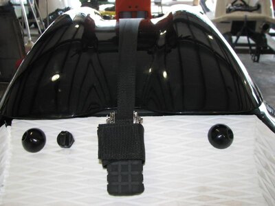

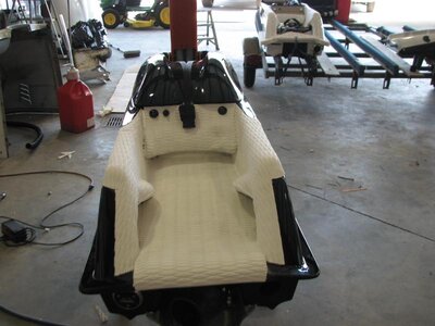

turfing is going to be fun with the ffh already installed:shocked:
The PPFFH comes right out, other wise it would suck! I just had it installed to see what the total weight would be, without turf/pad.
holy shiot! that baby rotates fast!
looks great. you are going to have to relearn how to ride on that baby.
Its going to be fun to ride, I'm already thinking what a Xscream 1000 would be like!
It sounds very nice. What is that starter relay in that photo with msd unit?
Mounted on my MSD plate, I have the MSD box, Starter RElay, & the new Shifty Relay mounted just below the starter relay. This relay turns the MSD on when you hit the Starter button, shuts the MSD off when you hit the kill button or pull the lanyard. Its a very nice set up, plus thats one less switch on the dash.
