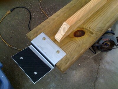

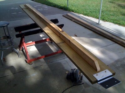

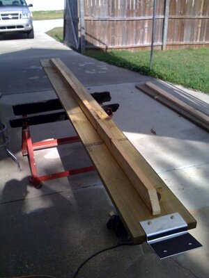

so far...
the ramps were pretty rigid w/o the runner under it, but not good enough. W/ the runner it is solid as hell. I rolled my bike up on it and stood on it myself (430lbs total). the ramp bowed about 1/4" -1/2" in the middle and that is w/i spec. The ends are made of extruded aluminum and are rated for 700lbs per unit. All in all, they turned out exactly the way I wanted them to. Next is adding turf and painting ryans name on it....
:smokin:
so far I have spent 91$, so I have 9$ left to get some stuff.. lol
3 2x12x12ft - 18$ ea
1 ramp ends - 23$
1 screws - 7$
3 2x4x12ft - free supplied by Enzofires
hydro turf - free supplied by me

you gonna lay a couple pieces of plywood so it's a solid surface to walk on?
or all we gonna be walking down one of the planks?
I made 3 individual pieces the same... that way it can be moved w/o an army. I can pick one completed ramp up by myself and carry it no prob. That's what I wanted. So to answer your question no plywood and you will be walking down the middle one.

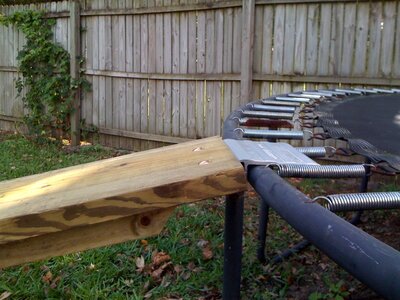

this pic looks like a backyard stunt about to go bad.... :lmao:
attachment.php
funny that you say... I did that on the MTB 3 times... it was a bitch getting used to riding over the trampoline... very funny feeling, but I pulled it w/o putting a foot down...
The last time I took a header off the right side onto the ground... :dead1:
