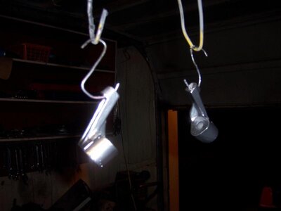

Went ahead and carved up my old bedplates and powdercoated them chrome. Figure a little bit of bling doesnt hurt to bad....
Eitherway doesnt matter, They wont fit without taking the motor out first to install them. Plus I forgot how close the battery tray is to the motor... I'll have to grind out an entire corner.
I think I may just buy outterwears....
At least they look pretty.... =\

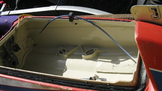

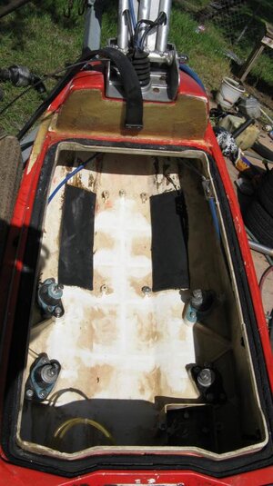

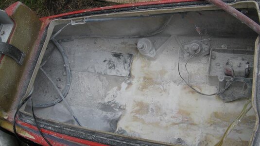

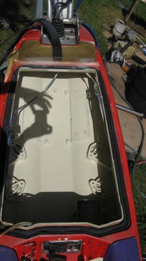

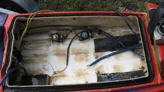

Welp.... I pulled the motor to do some general maintenance, some new motor mounts, new bendix, cleaning etc.
I cleaned out the engine bay finally, and ground down all the ribs and painted with some appliance epoxy. water and nuts can finally roll easily to the back of the bay without catching on all those annoying ribs the 550 has.

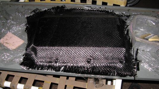

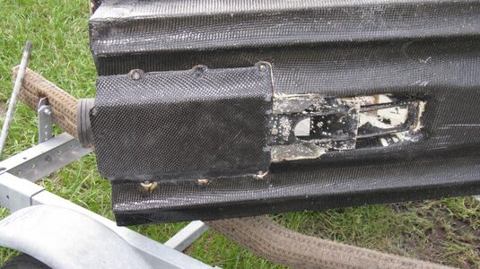

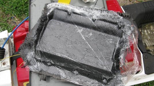

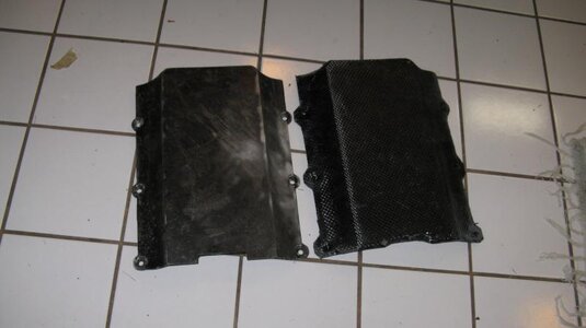

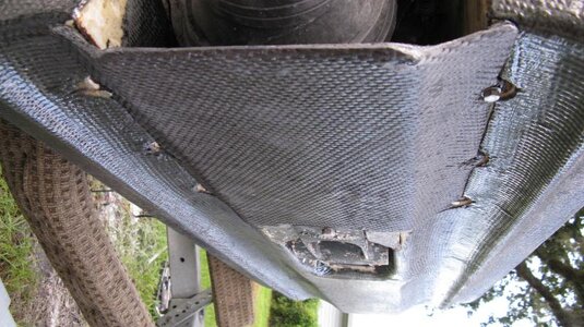

And then I decided to make a rideplate.
Still need to do final sanding and paint... Probably gonna cut it a lot shorter too...

Rideplate is to long, and Waay to damn slippery. Dunno why, its the same shape and dimensions as the original aluminum one....
Time for the D cut....
