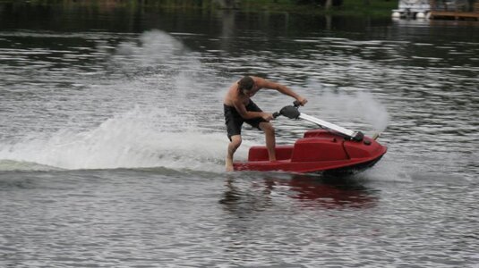

Fresh from today. Put the carbon bottom to the test.
Lots of rocks, cypress knees, and log jumps.
And damn does this thing ride perfect for this kinda stuff.

Sweet video!
Where were you riding at?? All I could think about was that is looks like GATOR country!
