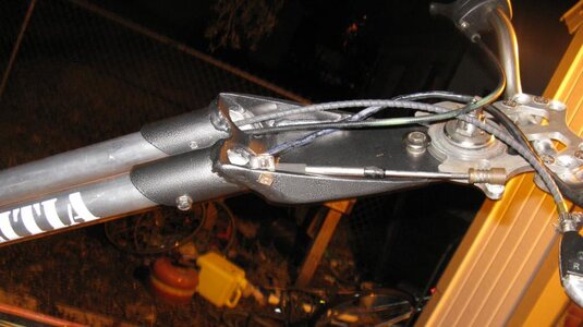

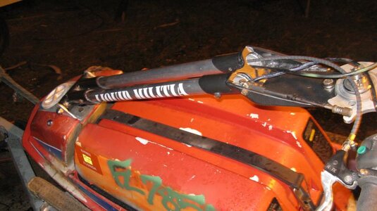

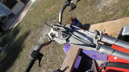

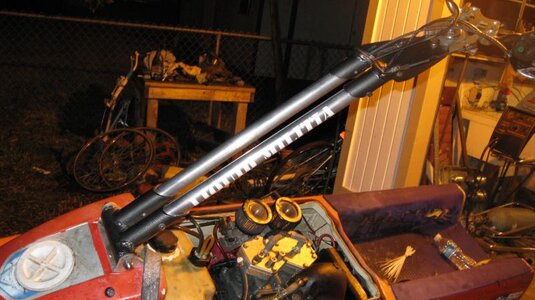

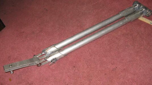

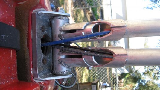

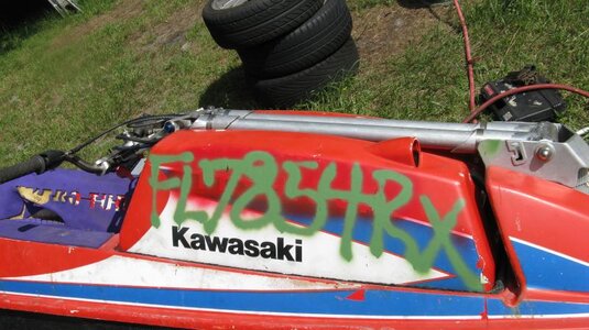

Just finished drillin, tappin, adjustin, and installin.
Band clamps are temp until i figure out actual length I want.
That looks SWEET!
I like how it looks all rough like that. So now you have like the "Bride of Frankenstein's" ski with a hint of Terminator.
I dig it. :)
Edit: I don't know about that PINK whistle though...lol!

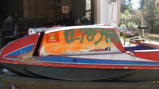

Guess its time to pull the ski out from under all the trash its been sitting under for nearly 4 months and get it running again...
On the block...
New Riva Orings for the head
shorten pole.
new nose
new hood
Rejet carbs.
OR
JETWORKS MOTOR

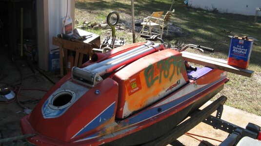

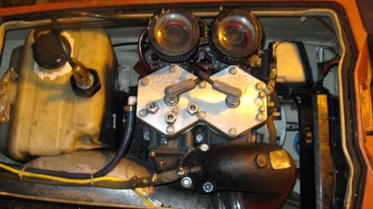

Ok.... Sooo spent some money, bought all new components for the E-box.
+ New JSS coil,
+ Yamaha Starter solonoid (finally getting rid of the kawi unit i was using),
+ Then I ripped out ALL the weird and bad wiring,
+ Solidered and sealed up new color correct wires with glue lined heat shrink.
+ New OEM E-box seal to replace the original 19 year old one.
+ Blasted and Powdercoated Ebox cover
+ New Bendix
+ Timing Cover Gasket
+ Replaced small 1 3/4" exh outlet with larger 2 1/8" outlet. Hopefully removing the extra backpressure i had. Also I found this is where I was leaking. All the silicone from the first outlet had decomposed.
And about to finish the new steering plate changes to my handle pole. May or may not start the nose project before this weekend... May be riding daytona again.
At least this time I KNOW I wont have any electrical issues.

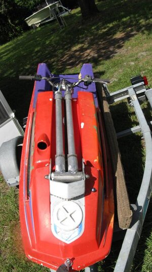

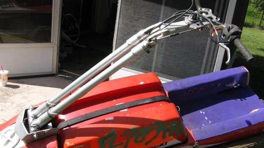

Done.
Glassing the nose next week I guess. The pole will be another 8" forward then.

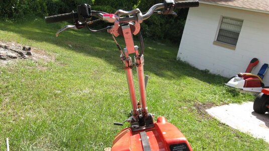

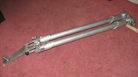

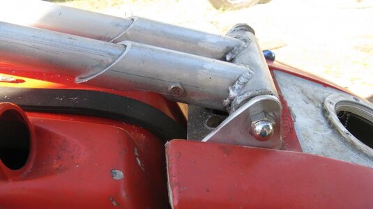

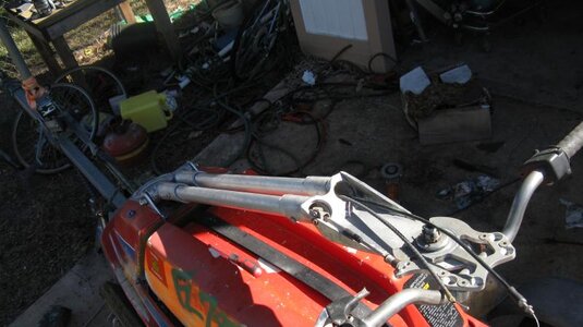

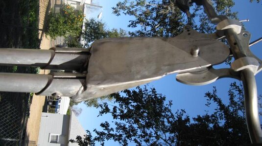

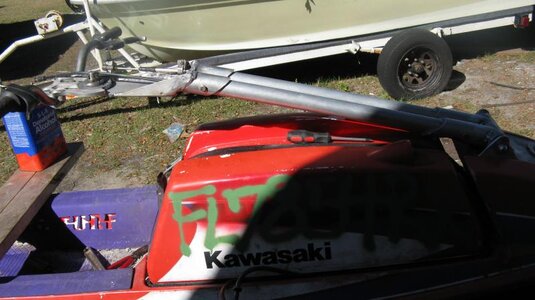

Heres the pole all finished with final hardware and powdercoated. Light polish on the center tubes. Also I took some time to organize the wires in the bay. GM weather packs on all connectors now.
Still something wrong in Ebox... I replaced new starter solonoid, it starts up fast and fine for 4 times, then nothin. no clicks, no smoke, no stink. I am baffled.
