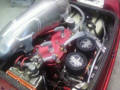

Yeahhhhhhhhhhhhhhhh, Its done. Thanks to Brian, Kyle and Dan.
Now that I have it.......Where in the heck do all these water lines go? Dont know how to run the water lines ?????
BR8EG plugs ?
Zachary..... Why does your motor have the large spacer plate under the Cylinder and mine doesn't? did you go larger than a 4mm stroker crank? Thought I was getting the largest displacement available. was told mine was a 870cc after all said and done. Orig thought it was going to be closer to a 1000cc ????? Just curious......
There she IS

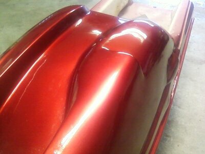

It was actually a lot easier then we thought to fit that monster in an sxi pro 2 cuts on the hull for the pipe a little grinding near the dry pipe stinger and its going to take some extensive hood trimming but all in all NOT BAD
Any ideas for exhaust kawi forgot the simple rubber pipe going forward arround the tank and coming back
I was thinking a combo of stainless and rubber hose like from a turbo shop
or some stainless steel flexi exhaust
could cut and bend one but thats a lot of time and welding bending and cutting
Any volunteers for helping sand paint and glass only the finest prime steaks and coldest budweiser in SD for guests

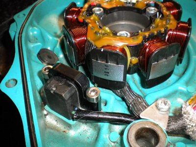

TOBEK and other Kawasaki ridersBillet pickup strap Kommander Ink.jpg - you need one more billet part. It's the billet clamp to hold your trigger pickup solid. Kommander Industries sells them and you wont loose your pickup. Once you go high rpm or big bore the vibrations kick up and the plastic weld of the stock black pickup fails on the retaining tab. This nice pc. from Kommander will prevent failures. Nice addition to your billet.

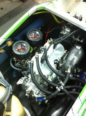

I love my Kawi Based DASA setup, ive only had it for a few months, no problems at all. Rode this motor at World Finals in AM freestyle in a Trinity EVO Pro, it rips for sure!
Daniel
Martin33
LIVE ACTION !
Azle, Texas
4 mil stroke, Novi 46s, wet pipe (Had to modify headpipe to clear PV), bone stock electrics, TBM flywheel.....pretty simple and very reliable
