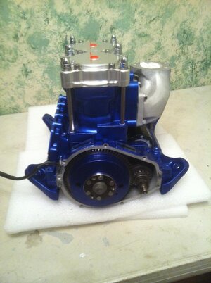

thats the plus bout owning your own house with out a women, u can have ur ski inside an build your motor in the kitchen an theres no1 complaining. i jus have less money to put towards it, not that i dont already got enough into it already
