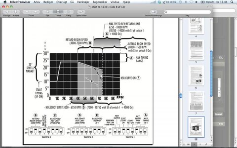

Pablo, i think you might be wrong here.
I think you running 28 deg static timing till 6000 rpm, where the curves starting to drop till MAX retard (max=15-28deg) ending up with 13 deg at 9000rpm.
Could someon please confirm weather this is right or not.
Thanks
Penken
whoomp there it is!
Umeå, Sweden
i definatly think pablo wrote it wrong
your motor is not going to love a 28 retard at 9000rpms.
the reason you reduce timing at higher rpms is cause the motor comes on the pipe and the filling of motor is increased and will cause detonation if the timing is to high. reson why you can hold a different timing with different pipes. dry pipes can retard timing later. wet pipes earlier cause they come on the pipe sooner.
