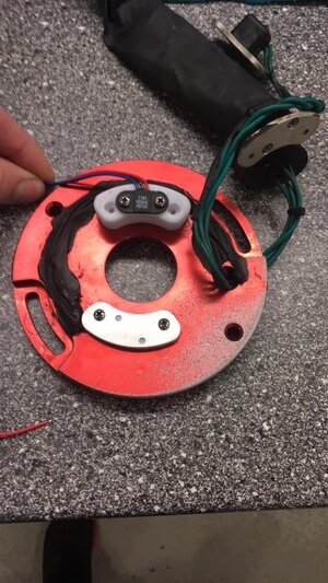

Any progress with getting the brain plug and play with a MSD setup? New ski has a nice full MSD TL system in it but if/when the brain takes a crap I would like a cheaper replacement option!
Nice! Hopefully my MSD doesnt take a crap on me until you guys finish testing =DHey man, well yes and no.
My buddy got the brain for 2 channel (for hall sensors) and have to adapt the hall sensors to MSD pickup plate.
But i think that will be in the start of 2019. He is waiting on a new hull. Dont think he is gonna try it in the old hull![]()
