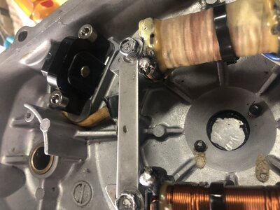

I have never had this come apart. I wonder if its the heat build up
Twin pipes on an 820cc mod SXR and KHI ignition superjet 86mm flat top Lamey drove the need. Common failure with serious all out rpm hp motors. Not these freestyle builds or normal hot setups.
