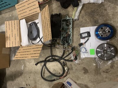

Awesome Thread! Compiling the components to do this before spring. Can someone tell me the length of the longer two lobes on the 760 flywheel. I've got a flywheel that I think they've been altered on and need a measurement to check.
Thanks in advance

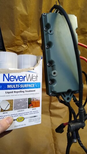

I’m looking at designing a ebox for the kawi 1100. I want to use this system and kawi components. A quick question is are all the boxes dimensionally the same? Or does some one have a 1100 box that could measure for me so I can get started on this project. The end goal would be a lightweight box that would work in a blaster or Superjet 1100 swap.
Quinc
Buy a Superjet
California
kawa 1100 ebox looks like this:
1531111712_Kawasaki1100ZXI1100STX900ZXIElectricalCaseRestorationService_JULY2018Batch1004.jpg

I left the flywheel on and used an air die grinder to remove the lump. Stuffed some damp paper towels around the case to catch the particles. No issues and seems to run fine. But, I haven't run it long term to see if there are any issues

Finally got around to installing mine and first time I have see the coil ground wire screwed to the screw holding the coil in the ebox. (Stock 760 ebox) Vs the 701 connects to the coil.

Mines is suppose to arrive tomorrow, I'm pumped to install it tomorrow. It's the last part I needed to finish my 760 swap

Well motha fuq! Damn lord mount bracket for the blaster mod pipe does not fit on the 760 flywheel cover! :(
