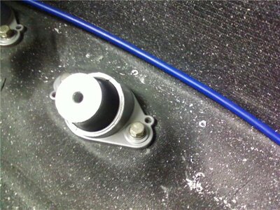

:beerchug:drilled holes and installed pole bracket (pic3)

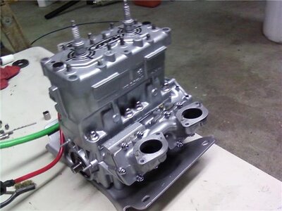

ainted and installed motor mounts (pic2)
:beerchug:intalled fresh steering cable (pic2)

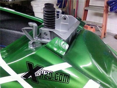

:beerchug:front and rear hook drilled and installed (pic 1 w/giant waterbox in background)
