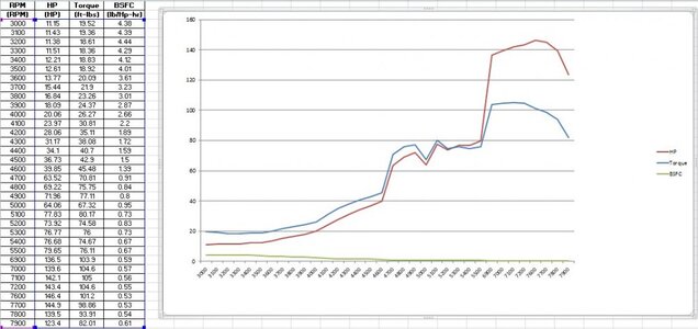

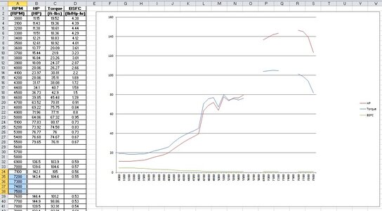

But that dyno sheet is missing a bunch of numbers.......
Why can't you compare a race engine and a freestyle engine? It's all about horse power and torque right? Does a race engine not make horsepower or torque? Does one not run on gasoline? Like I don't get it......
Race motors usually have a high port timing which is not what you want in a freestyle setup a stock 760 motor with higher pt is 20 more hp then a 61x but we all run 61x cylinders just saying a race motor may have a ton of hp but not when you want it just my 2cents

Well since you guys have the dyno at your disposal it would only make sense to get your hands on some other brands and get some numbers out there. Id rather brag on the Internet that my engine makes more power (with proof) than oh hey look at me I have dyno and only have dyno sheets for my own engines. From a marketing standpoint this would make sense.
Kinda sounds like a hull mfg I know of. Tons of fancy stats on their revolutionary hull material on their fancy website, but no comparative information to the material used in rest of the industry.
Bravo to E-Tech for posting dyno results. Brian has a point, its tough to know if your numbers are good without some contrasting data. I 100% agree, a 701 with a B-pipe and a Enhancer would probably be a good baseline.

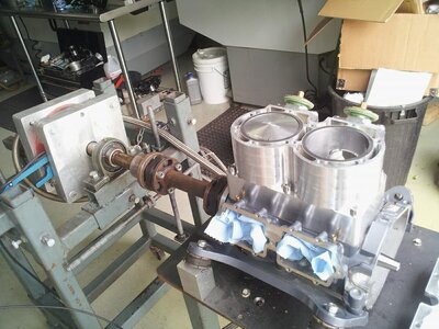

So, sort of off topic, how does that dyno load the motor? If its long winded or not worth discussing don't sweat it. Just curious how it works, because so many here say that running our motors on a dyno is pointless etc.
just having and ...using a dyno to test changes in porting and other motor changes and supporting bolt ons is impressive in this community of seat of pantsers and hype pushers. When you post results of your own 2 motors for buyers to review on the most competitive priced motor in the market,your doing something right. I dont think anyone really believes this is anything close to a copy of another design. Real results,less hype is nice to see here
ON
I use a Land and Sea water brake and software controlled by hand or or auto load water valve. I prefer the operate the valve manually.
The dyno stand i built 15 years ago.
