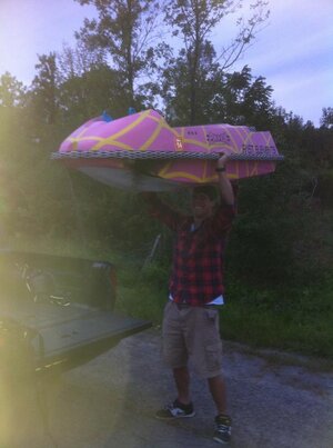

Here are some pictures I took real quick with my cell phone, better build pictures will be taken with an actual camera. Any pointers, thoughts or ideas just let me know.

Sorry guys I forgot a few little important things, the hull is a -4.3 carbon. While I was still at work not being productive I decided to weigh the hull and hood.
The hull came in right under 56 lbs. and the hood was 8 lbs.

There will be plenty of pictures to come, I will hopefully have a bunch to upload later tonight or tomorrow morning.
