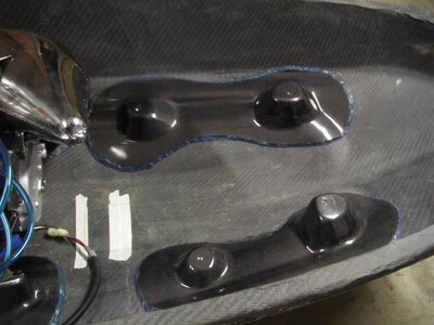

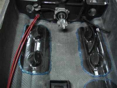

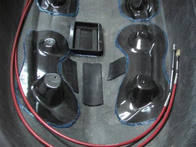

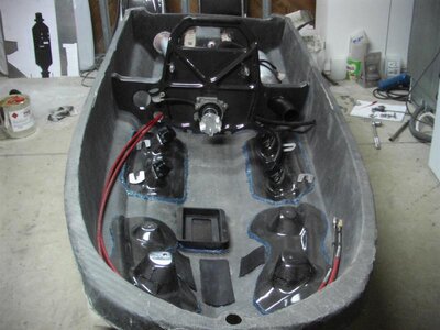

Here are some pics of the carbon engine mount base, carbon Battery box & carbon fuel tank mounts.
The rear engine mounts use 1mm shims & the front use 1.5mm shims to line the engine up.
The coupler housing uses no shims as the pump, bulkhead & engine mount bases (with the shims mentioned above) are aligned perfectly.
Fuel tank mounts are designed to bolt the standard blaster tank straight in.
