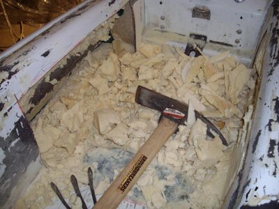

tonights progress:
I was able to spend a few hours tonight. I managed to sawsall a bit through my rideplate area... nothing a little epoxy and glass wont fix though. Defoaming is a B I T C H, overall the foam was pretty dry with the exception of around the exhaust and the pump area. I also foamed the hood, will prob start shaping it tomorrow.... guess i need to also get a list and place an order with us composites. Kenny, would you mind shooting me a pm with what you used so i can have a rough idea how much shiot i will be needing.
