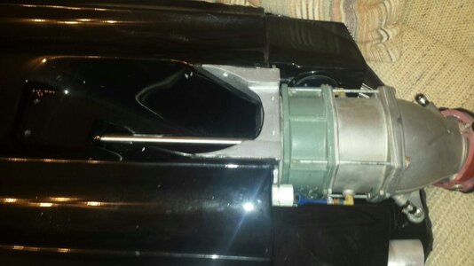

Footrocket Build
Finally made some progress

Did you end up screwing the pump shoe up tight against the mounting surface? Or did you have to leave a gap to get proper alignment?

I did not use any screws. There is a slight gap between the shoe and hull

Ya i have heard that screws are a big no no on aftermarket hull, I used G-Flex epoxy glue on alan's XFS.
Just wondering: did you do your shaft/pump alignment off the shaft tube on midshaft housing? What type of glue did you us, looks like 5200.

Well the person that installed the duct shoe is this XFS screwed/glued it, the pump didn't line up right and blew out the new seal, so i got to chisel out a brand new duct shoe on a brand new XFS and do it right, zero issues ever since. Maybe footrockets are more sqaure?
Me too. It was too late by the time I heard the mounting surface wasn't perpendicular. Craziness. It should be square, and I can't imagine a viable argument for why it shouldn't be.
I was told the reason aftermarket are not usually sqaure is because they are hand laid vs a million dollar pressure SMC mold that yamaha has.
Makes sense, but proper fixturing can get you a long way. The machine yamaha molds them in is two stories tall. It's in Lincoln, NE. I don't expect hull builders to go that route, but they're not making thousands of them on a strict work schedule either. I don't know the process well at all, but I know my vision hull was closer than my foot rocket that costs twice as much.
