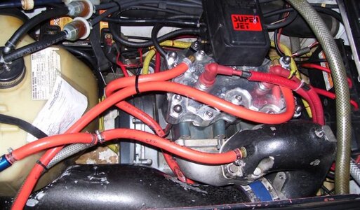

Mouthfulloflake
ISJWTA member #2
NW Arkansas
here is a pic.
I dont think its a weak supply, but did you see several posts above about the casting flash? maybe I need to pull the head pipe and clean it up a bit...
i can dry it out enough to have some DECENT bottom end, but its not pulling the peak RPMS IM used to.
You must have a water supply problem, either the supply is weak to engine or weak feeding the headpipe or the headpipe holes are clogged up.
Make sure you have a good headgasket seal too.
Post how you have the water lines set-up.
