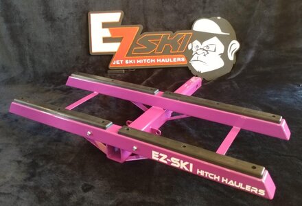

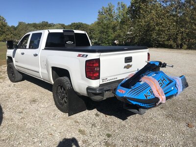

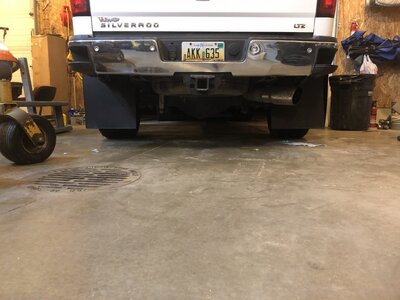

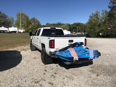

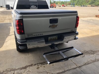

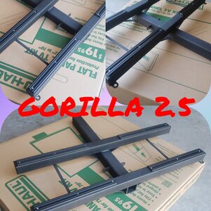

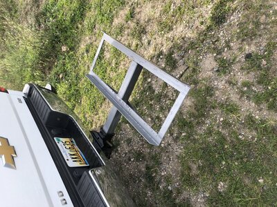

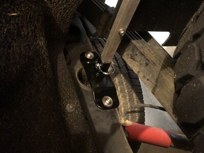

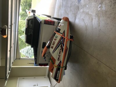

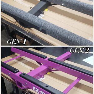

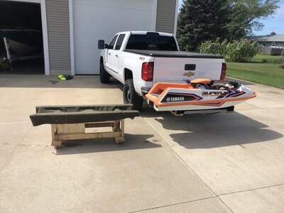

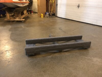

Nice job . we make a 2.5" as well .. we labeled it as our Gorrilla Hitch ..pic below.. all metal with teflon slidesI built my own hitch hauler in about an hour and a half. My Duramax has a 2.5” receiver and I hate the added slop with the receiver reducer to get back to the standard 2” hitch shank. So my main tube is 2.5” 1/4 wall and the rest is angle / flat stock to try and keep it light yet strong. One of the main places I ride is a gravel shore - zero sand - so I wanted to be able to beach the ski but not destroy the bottom of it. Hence the hitch hauler / beach stand combo. The stand fits in the hitch hauler tight, and the ratchet straps that go on the ski always go to the hauler - not to the beach stand. Works awesome couldn’t be happier. It works pretty well to watch the back yo camera - you can watch the ski start to float and know just when to stop.
-Ross
View attachment 384350View attachment 384351View attachment 384352View attachment 384353View attachment 384354View attachment 384355View attachment 384356
Love the Teflon coated! I’m in fresh water in Michigan so couple primer and a few coats of paint will do for me! Still need to find a way to haul the ski and the skater at the same time.... stand by!Nice job . we make a 2.5" as well .. we labeled it as our Gorrilla Hitch ..pic below.. all metal with teflon slides

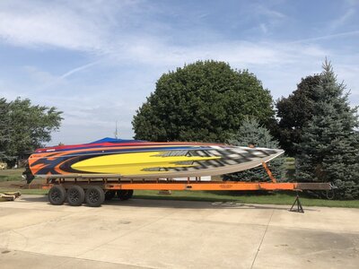

Nice boat....!!!! I wouldn't tow that beiind a hitch hauler... TAKE ME FOR A RIDE!!!What’s it rated for Chris? I don’t like the thought of the extra 2.5’ of leverage on the hitch receiver. I’ve got quite a bit of room on the tongue of the trailer I think I’ll weld a 3” OD 1/4” wall tube to the tongue of the trailer and put the ski hitch hauler on that.
Start a build thread here!!!!!!!!!!!!!! This would be interesting to see.Thanks fellas. It will be another year or so before the boat is done as I’ve got the transom cut off of it at the moment. Going to do a wrap around windshield, try to make the cockpit a 6 seater, and add a bustle with steps on the back. Tons of work yet to do.
