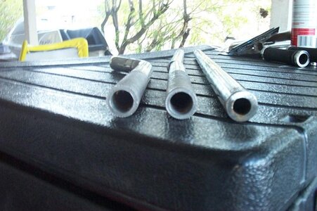

Well, titanium bars were not in the books for me as it would of cost over $200+ for a piece of tubing. So I went with 4130 Chromoly. It was $16 a foot. I got 25" for $32. Think I'm just gonna sand, prime and paint it with some good polyurentane single stage and fill the inside with resin just to keep water out.
This was material left over from making tie rods for a high performance sand rail. I found it at my machine shop here in town. Its wall thickness is prolly 4mm. I dont think I will ever bend or break this! Should last me my life time..lol On the down side it does weigh like 3 lbs. or so.

I had a set of cromo bars that I made on my sx. They worked great, a little heavy, but better than breaking one and having the other half go into your chest!
Yeah, your right, maybe I better re-think this again! :439:
While you are rethinking this , let me suggest the following: go to www.mcmaster.com and type in (search is already open):1658t53 that is an 8' lenght of 7/8 6063(T5) aluminum tubing with a wall thickness of .219". It is architectural grade, an alloy not easily corroded. About $32. Ask them to cut it in half for easier shipping.
