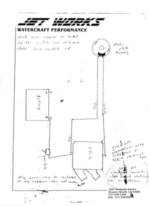

OK so there are some people that think this setup won't work. Prove them wrong with a video of the setup and then with it running. You can cut a flywheel cover in half to show the flywheel and trigger plate and then start it up. Even if it is a 20 minute video of you assembling the flywheel and cover after showing the trigger plate and wiring. I am sure we would all watch it.

Hey Terry, will his system work using an OEM Yamaha or Kawi coil?
1 coil.
1. plate with a pickup.
1. Battery
Battery wired to the coil, coil wired to pickups.

any two wire coil will work in this setup. i was running it on the x2 before i got the analog setup for safty.
