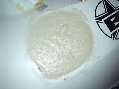

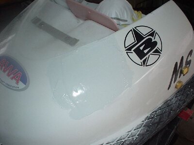

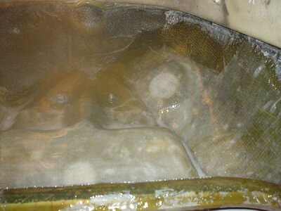

I just did this mod to my boat and the info in here was priceless .
It gave me a lot of ideas but I just went with the simple put the filler on the top of the tank :cool2: It cost me 5 bucks total .:arms:
I blocked off the old filler with a 2-1/16 rubber plug with a hose clamp and then a 2 inch galvanized rubber twist type stopper for back up .
Glassed over the fill on the ski and done :Banane01:

that tank might be a bitch to install with that dong hangin out the front LOL
get some pics of the top of the tank too!:Banane01:

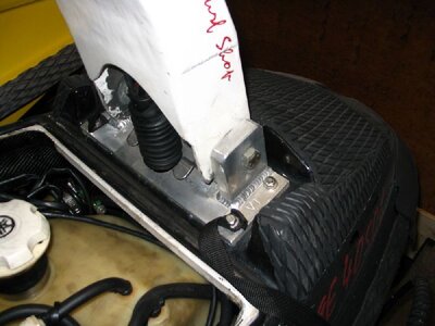

internal fuel filler
here's how I did mine, didn't have to cut the tank at all, just had to shorten the filler neck, so it wouldn't stick up too high, clears the liner on my old square nose. And the fuel lines pick up were the filler hose use to be. Two Tank Straps is definetely better than one.

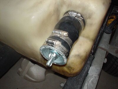

Here's the top of my tank .I can still use both tank straps this way .
I used a little bit of 5200 around the seal for the filler
I'm thinking about glassing over the old filler .
West Systems will stick to this right .????
