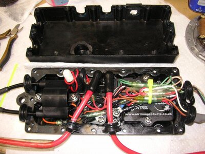

Electrical System Build:
Using couch ebox back with threaded spots for 3 bolt mounting to bulkhead. Some have also used the CF ebox mount with this ebox style.
Epoxied spacers on the back for better cable routing options.
Ebox ready to rip. Epic ignition, JSS coil, oem 62t stator and cables.

Ebox is finished. Electrics ready for install.
