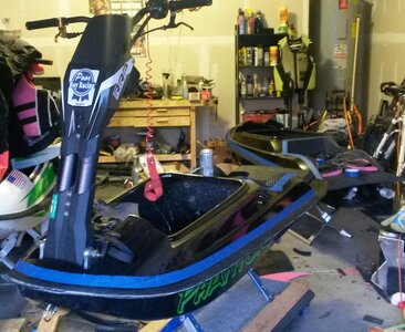

I'm finally getting to work on the Phantom! I've been making lots of billet parts for her in the last few weeks, but haven't actually worked on the ski itself until now. I seem to have forgotten how annoying turfing is...and wound up a little disappointed in how it's turning out.

Kaylee,
so did you just use a standard X-4 steering nozzle? Did it bolt right up to where you needed it, or did you have to make any modifications to it?

What's an x4 steering nozzle? I used a standard 155 63m yamaha reduction nozzle. My trim ring and a protec yamaha steering nozzle. Everything bolts right up! :p;)

Ahh, when you said the "Yama-doo" thing, I thought you frankensteined some parts from a Seadoo. That steering nozzle looked similar to the three Seadoo nozzles I have hanging on my wall. (X-4 is the hull design for most late 90's SD 2 strokes, most of the parts also fit on my HX)
