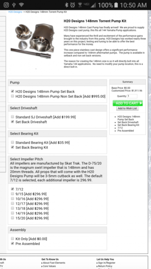

Just sent almost $3K to JetManiac for the Torrent kit, midshafts, trim etc! Le sigh haha, but I'm excited!
Thanks for the impeller size input, I'll see what JM says as well.

Looks like the H2O pump has the 7/12 option so I guess I should go with that? Few people run the Group K engine so my research turned up little to nothing. JM said 6 or 7 / 12 to 14 should be good.

Really depends on how hard the groupK pulls/power curve, never ridden one.
My buddies 771 pulled the 7/12 well in a rickter. I've heard group K make good mid to top, so maybe a 6/14.
Or maybe a 6/15 cutback 5mm, but run a thick washer and space it closer and closer to load the pump harder/dial it in.
Either way your be close if you go with JM said.
I run a GroupK 718 61-X with a 7/14. Thing pulls really hard the whole way. Feels like it has a little much in the top end ( thing hauls azz!) but hits well in the low end as well. Eats gas like a v-12 biturbo. GroupK does a great job IMO. A lot of their builds basically say stick with stock head, stock water box, stock ignition.

Have a 785 groupk single carb in my blaster. its been a salt machine for 6 years and still hits hard in a blaster. believe its a 7/14 as well but cant remeber

your prop pitch will also be determined by your reduction nozzle size. I think you should try to get ahold of groupK and ask them just make sure they know its not for racing lol

I'm going to go with the 7/14. Getting the RRP trim and reduction nozzle setup.
The Group K kit was for freestyle and came with an impeller, but it is for a stock SJ pump.

i think you will spin that prop like a top with that bigger motor you are using! i had a 701 ported in my predator and ended up spinning a 9/17 we ended up with a 12/18 need to remember your ski is shorter than most! like to see how it works though!
