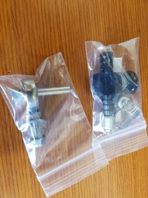

Big thanks to JetManiac for the fast shipping! Been a big help, just got my heim joint for the RRP trim and water restrictor in the mail.

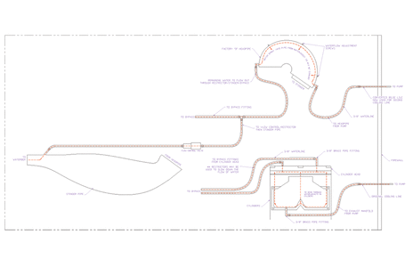

I found this dual cooling w bpipe diagram. Makes sense to me, I have a T on the bottom of my mani, but same difference I think.
I'm a n00b, so any reason why I shouldn't route my cooling like this?

That's one way to do it. You could also run both to the bottom of the manifold. One out the head overboard and the other to the bottom of the headpipe. Then out the top of the headpipe to a T. One side of the T to flow control valve and bpipe stinger and the other side overboard. @yamarider knows how XScream does it. I think they go from the head to top of headpipe instead of bottom

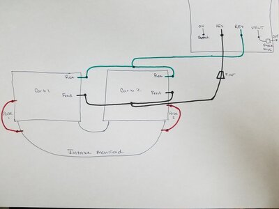

Sketchy artwork time. Running dual 44s on the Group K engine. I believe it is tapped for two pulse lines so I drew it like so.
Won't be using a fuel selector, on all the time. Will be installing a primer though, guessing that Ts into the feed.
On the right track?

Another tip is to make your pulse lines long enough so you can unbolt your carbs and set them on top of your motor/tank to rejet and work on. It's so nice not having to pull lines off every time you pop your carbs off

I saw some threads people said to feed each by extending the ON tube to be the same length? But others said it isn't really needed, depends on the engine I'd guess.
If I am not mistaken that will weaken your pulse signal (Pressure).
