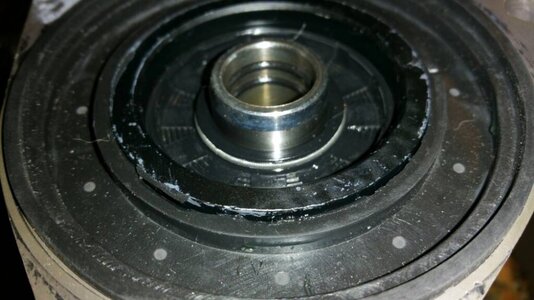

Yeah thats the one from krash. Both sides have springs.It looks like you separated the rubber from the inner bearing housing. You have the wrong seal on the rear. You need a double lipped seal without the spring in the back. Is that a Krash housing? It doesn't look like any I am familiar with.

I tried pressing it in cold "sat in the fridge for almost a week" and It got stuck about half way in..

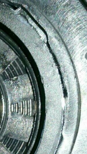

Yup its cracked and ruined lol, Plus from what JM said it had the wrong seals in it to begin with...What I ment by cold press, is no heating or freezing. But if you put it in the deep freeze, it should fall right in. Something must not be right.
Maybe it's a illusion, but looks like the inner housing is coming apart from the rubber.
