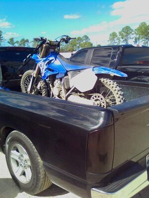

edit: this photo is what i did to my bike at the track today. fat boys, big jumps, and rear springs dont mix well.
the actual spring broke. its only been on the bike for like 4-5 weeks too. i'm gonna call factory connection tomorrow and see if they'll replace it for me. that aint right!
